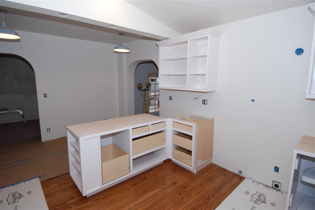

Boxes built. I still need to build the bar separating den from kitchen and fridge enclosure and pantry unit. Mid-late this week I will be edge banding all cabs and installing legs on the lowers, so they are ready to be stained/lacquered by weekend. Next week will be final install, call the granite guys, order all the doors/drawer fronts and the drawer boxes.
Lowers are all sitting at various heights. Sink cab is the only one that is at actual height. By final install, all will be at 34.5". They are just sitting there temporarily because my garage isnt big enough to hold them all and continue to build stuff.

Matthew, do you like how I hung the uppers? There is a steel track screwed to the studs, and each upper has two brackets (which are adjustable in/out and up/down) and you literally just hang them up there, attach the cabs together, and then put one or two screws in and call it a day.

Yup. Variation on the french cleat. Makes installing cabinets a breeze.

Matthew, what material are your drawers made out of? 5/8" Baltic birch ply seems good enough for me, but they also come in wood stock, but of course they cost more. What glides did you go with?
The full extension self-close are $16 each x 2 per drawer times 21 drawers and that is a hefty price tag. Edit: nevermind, I just found the specification, sold as pairs. Ill probably get these then
I will have to look. I gave carte blanch to the cabinet maker. My dad was ooohing and aaaaahing over the construction of them, and the plywood componets of them were bazillion ply, premium stuff.
I got the nice plywood as well, $58 a sheet for maple. My dad was amazed at how much nicer it is than what you get at Lowes/HD. I brought home 10 sheets of 3/4" in my pickmeup. When you rip it, aside from being able to see the layers, it was filled so well it could have been stock. Beautiful stuff.
I went back and looked at your pics. and it is nearly impossible to tell without a closeup, but you have one drawer box that is huge, Id guess roughly 14" tall, and most likely the baltic birch. 14" wide stock would be really expensive, if they even make it that wide. Plus the color of the boxes is so uniform and looks to be an identical match to the unpainted cab sides.
You talking about this one?
That's a pull out waste/recyclable.
Yes, but this pic which shows the drawer boxes without the fronts. That particular box is quite tall, and I would imagine that would lend itself to ply rather than wood stock. All the other boxes have the same uniform, clear color (without knots or other markings), which also match the unpainted cabinet sides. So my guess is that your boxes are baltic plywood.
