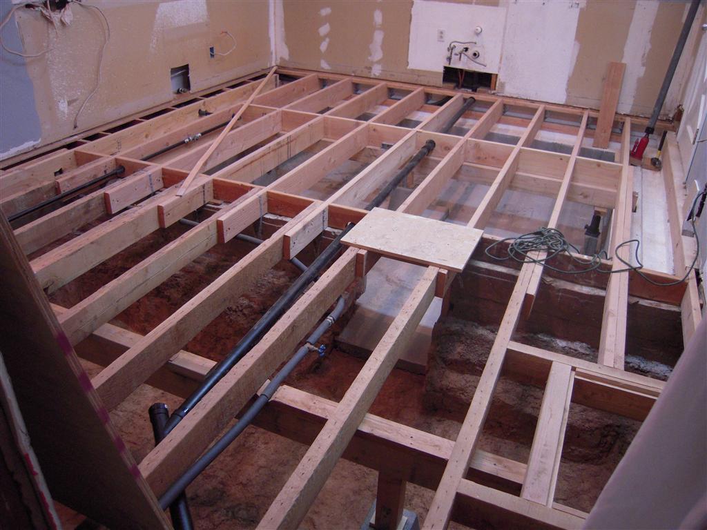

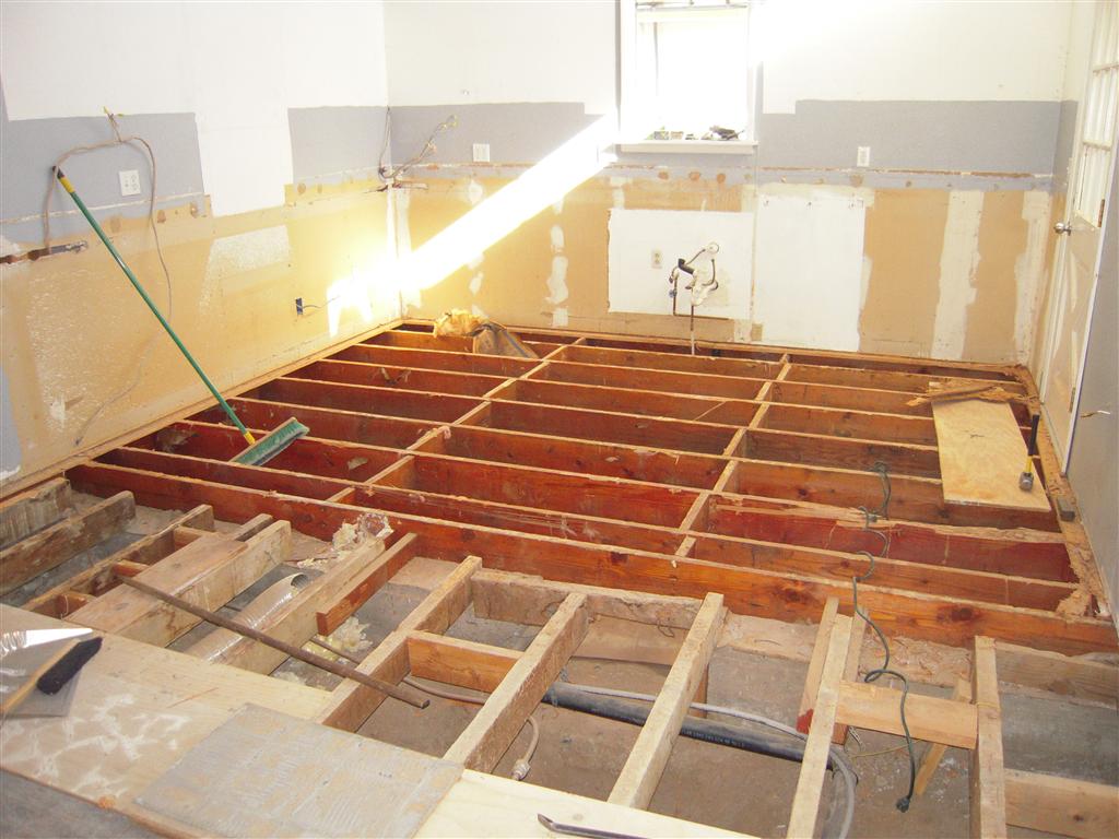

UGH. They had laid 1/2" MDF on top of 3/4" plywood for the subfloors in the kitchen and baths of htis house. It did NOT hold up well.Edit: I used 3/4" MDF for my floor. HD had it on sale and I bought some damaged pieces and it has held up fine.
