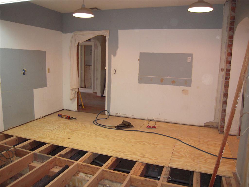

A bead of liquid nails will go a long way towards the strength of the whole mess as well. Lay it as though you were laying any other floor.
Make it look like this.
